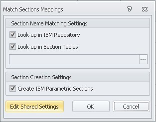

    During a repository operation: Click Edit Shared Settings on the Match Section Mappings dialog.
