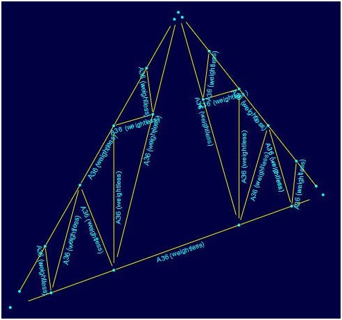

Vertical web elements will be imported as columns unless you set them to be braces. This can cause a problem if the vertical element does not exist in a Revit column family. An example would be if you use double angles to model the truss. There is no out-of-the-box Double Angle Column family in Revit.

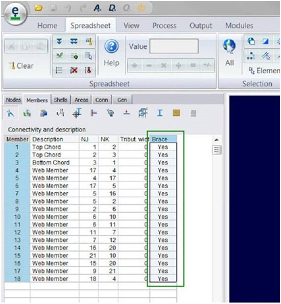

Set the Brace property for the different elements to Yes.

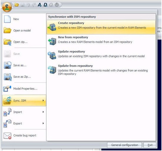

Design the truss and use the Sync. ISM > Create Repository to create the new repository model.

All of the web elements will now be braces including the vertical web elements.

The repository can now be brought into Revit with the New From Repository command.
