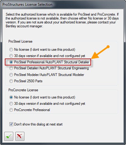

2. Open ProStructures then Check the license settings, you can do this by.
NOTE: It is important that you check this settings before activating the product. If the settings does not match with the license that you have this will cause to give you a prompt to activate the license every time you open the software.
For this scenario I have a valid license for ProSteel Professional/AutoPLANT Structural Detailer but does not have a license for ProConcrete.
3. After checking the settings close ProStructures.

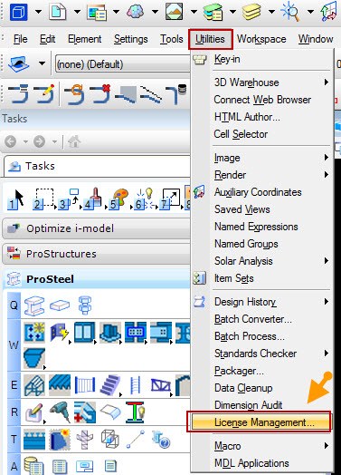

4. Now you need to open the License Management Tool to Activate the product.
Note: You can also access License Management tool Inisde ProSteel MicroStation by going to Utilities Menu.

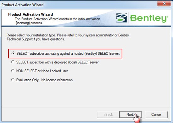

5. The License Management tool will open. Then go to > Tools > Product Activation Wizard
6. Once in the Product Activation Wizard, you are given the following options:
Choose the first option and then hit NEXT.
Hosted means: Your applications connect directly to a Bentley Hosted SELECTserver via the internet using the server name selectserver.bentley.com.
7. When selecting the "SELECT subscriber activating against a hosted (Bentley) SELECTserver," the server name will be filled in by default.

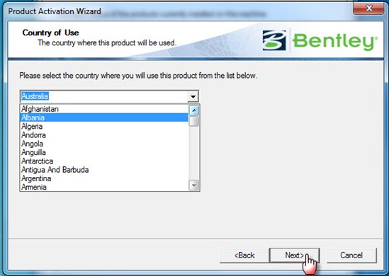

10. Select Country. Click NEXT
