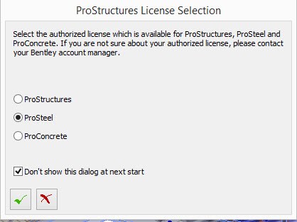

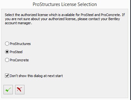

Checking the license settings within ProStructures/ProSteel. This is important so you may set if the license is not suppose to be in use and will not report usages to Select Server Online.

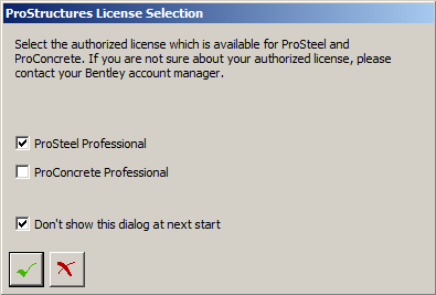

Steps to Check the license settings within ProStructures/ProSteel. (AutoCAD)
      1.   Open ProStructures then Check the license settings by.
For this scenario I have a valid license for ProSteel Professional/AutoPLANT Structural Detailer but does not have a license for ProConcrete.

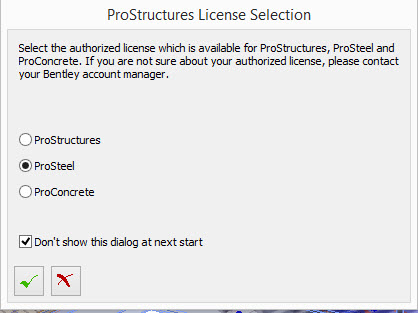

Steps to Check the license settings within ProStructures/ProSteel. (MicroStation)
In Connect Edition go to
the Backstage / Files
in Configuration;
Set Licence
For this scenario I have a valid license for ProSteel Professional/AutoPLANT Structural Detailer / ProSteel but does not have a license for ProConcrete.
