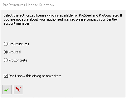

a) Open ProStructures and then Check the license settings, you can do this by.
NOTE: It is important that you should check  this settings before activating the product. If the settings does not match with the license that you have, this will cause to give you a prompt to activate the license every time you open the software.
b) For this scenario I have a valid license for ProSteel, but does not have a license for ProConcrete.
c) After checking the License type, close ProStructures.
