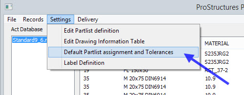

Open the Partlist Editor via create Partlist / Settings / edit Partlist Definition

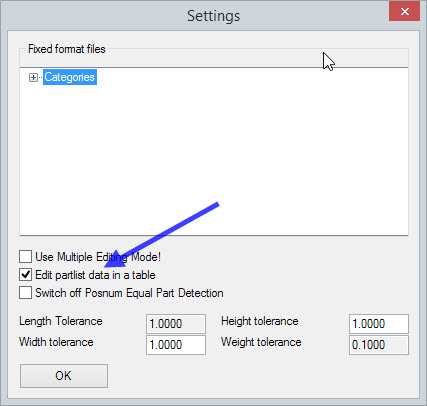

    Open the setting for the partlist.
  2. Switch on the display as table.

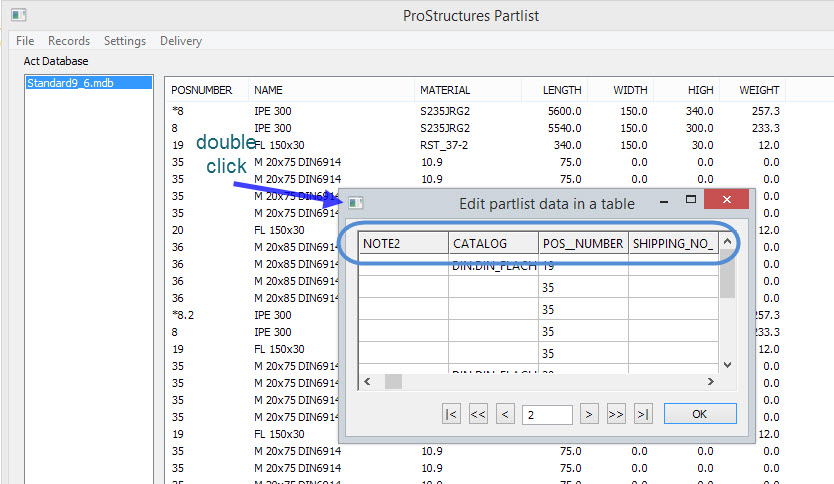

  3. Now the part list can be displayed as a table.
    Search for the column headers you like the part list sorted at.
    For example POS__NUMBER for the position number.

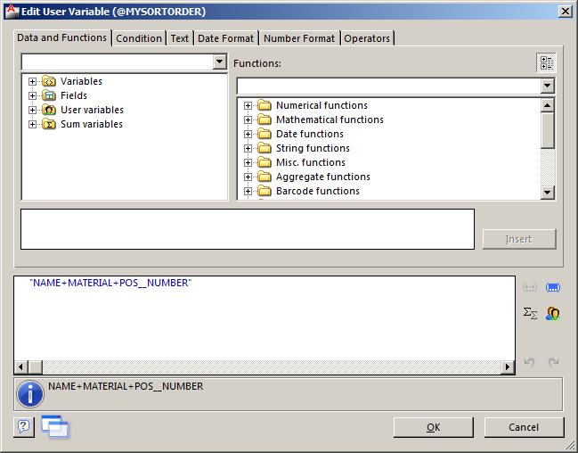

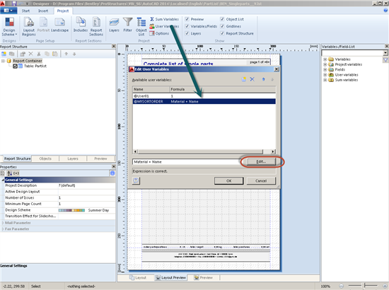

  1. Goto Uservariables and edit in the Partlisteditor
  2. add MYSORTORDER as a Uservariable
  3. Insert your wished sorting Variables by using edit
    like "Name+Material+POS__NUMBER"
  4. Result: In this case the Partlist is sorted first by name, than by Material and than by Positionumber
