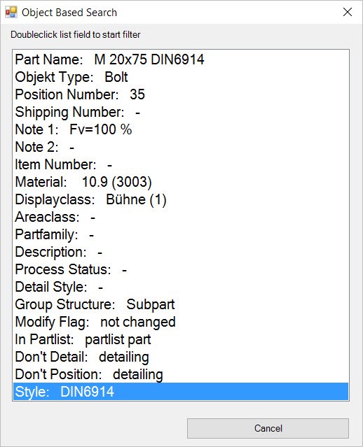

Object based search allows it to filter the drawing by different ProSteel Porperties based on the selected part.
After starting the feature and selecting a part following dialog appears.
Double click on a list field starts the filter.

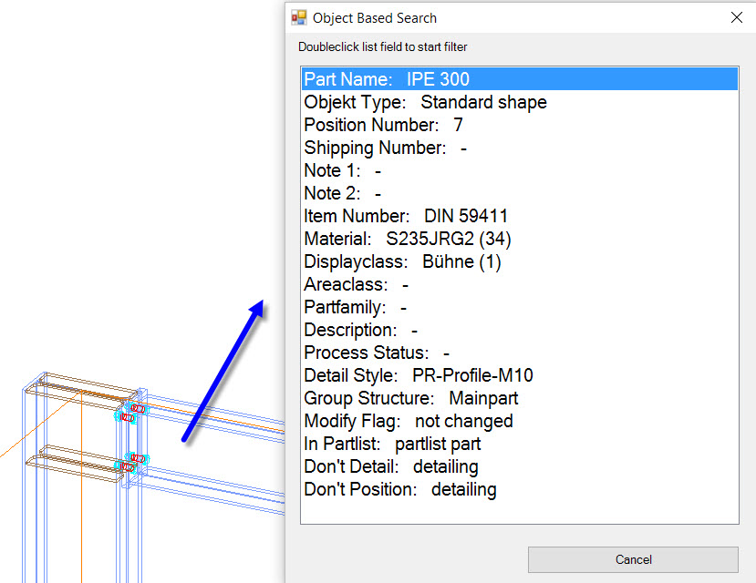

Here two more examples:

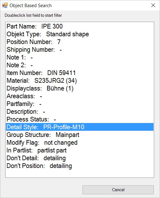

Single parts can be filtered by the assigned detail style.
Bolts and position flags can be filtered by the style.
