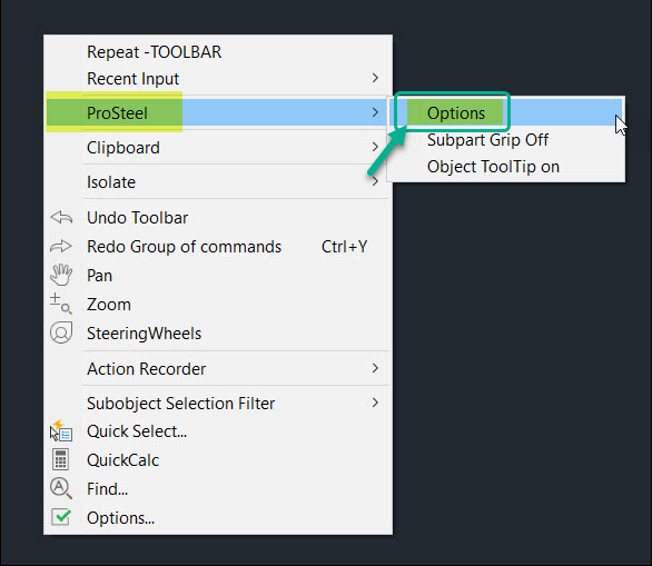

2. Right click in the working view and from the context menu select ProSteel > Options.

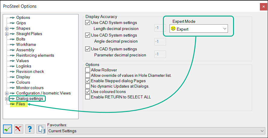

3. In the ProSteel Options dialog, scroll down to Dialog settings and select Expert Mode, that expands the Files tab for additional options.

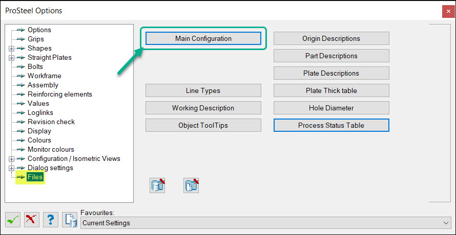

4. Select Files and then click on the Main Configuration.

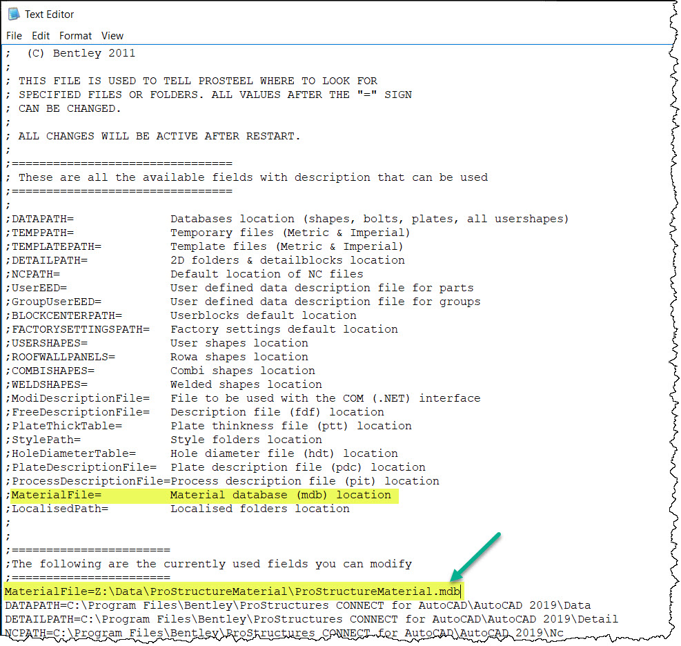

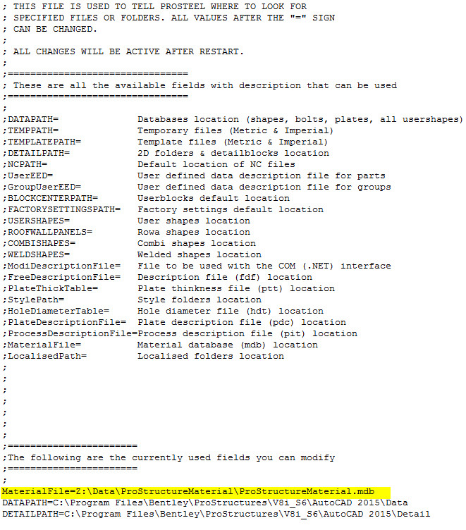

5. The Main Configuration file opens up in a text editor. Copy MaterialFile= from the list and paste it at the top of the file. Enter the path to the network location and include the full name of the database file as shown below.
In this way, one can set the material database location to a Network drive.
