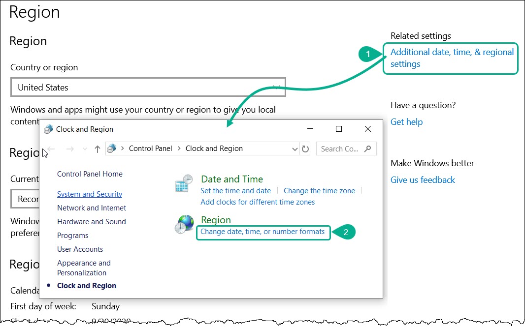

1. Setting Decimal Symbol as DOT (.):
First, please check the Decimal Symbol in the Region settings which should be a DOT or Full Stop (.). Please follow the below sub-steps to check this.
a. Please close the ProStructures application if it is open.

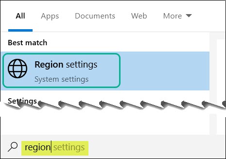

b. Search as Region Settings in the windows search and hit the Enter key.

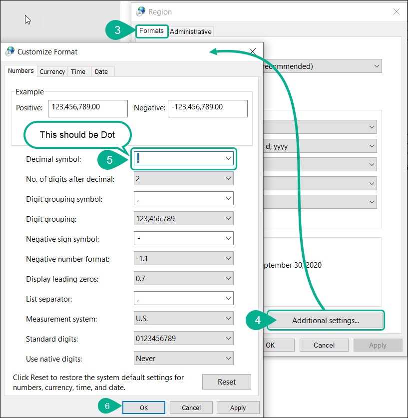

c. Please follow the steps as shown in the below images.
d. In the Customize Format dialog box, select the Dot (.) for the Decimal Symbol.
e. Now, re-launch the ProStructures application and check whether your issue is get resolved or not. If not, then please follow step 2.
