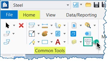

1. Navigate and left click on the Key-in button, located at Home > Common Tools > Key-in, or simply search it in the Search Ribbon at the right top corner.

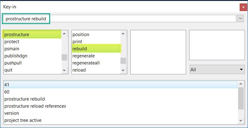

2. Now, type ProStructure Rebuild in the key-in dialog and then hit the enter key.

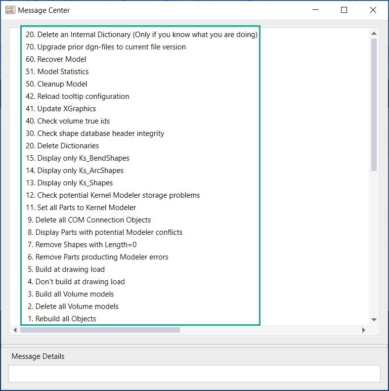

3. Message Center dialog will open with several options as shown in the below image.

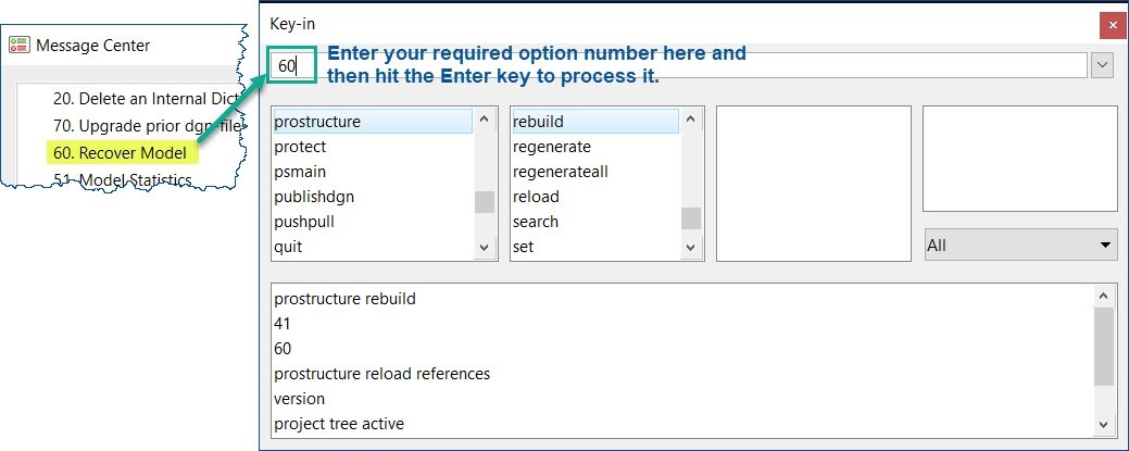

4. Keep the Message Center dialog open and then enter your required option number (e.g. 60) from the above several options in the Key-in dialog and then hit enter key to rebuild the model with the chosen option.
Following are the few options that are commonly used to rebuild the model if something is broken-
60 to recover and rebuild the elements in the model.
50 to clean up the model.
41 for updating Graphics and non-reacting elements.
