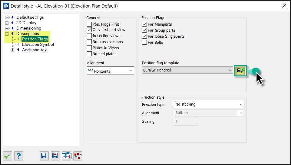

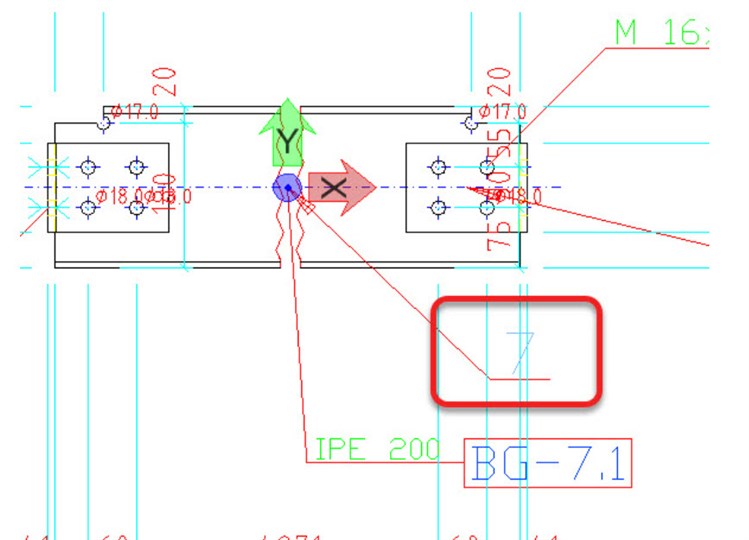

During the 2D drawing generation process, position flags are created for the assembly and main part. How can the main part flag be displayed ?

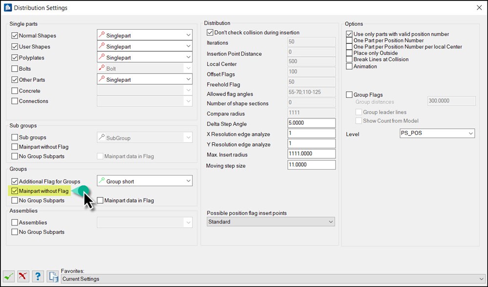

While editing the detail style under Descriptions / Position Flags, open the settings for the position flag distribution.

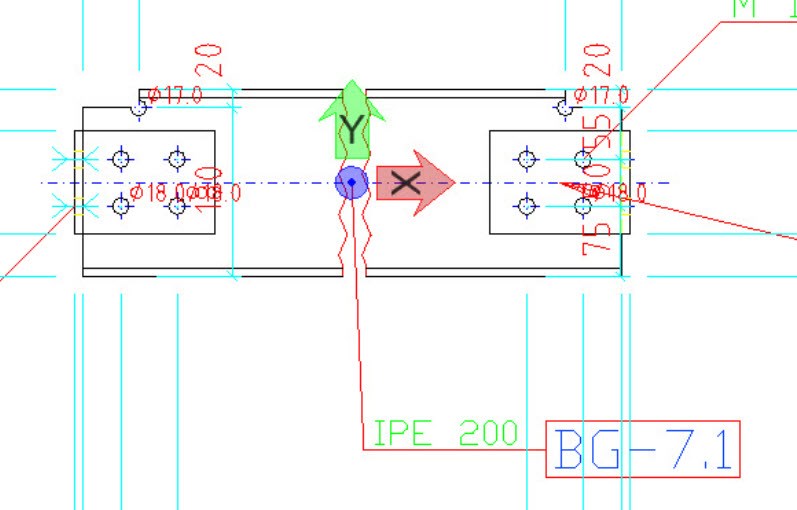

Activate the option – Mainpart without Flag.
