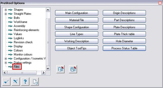

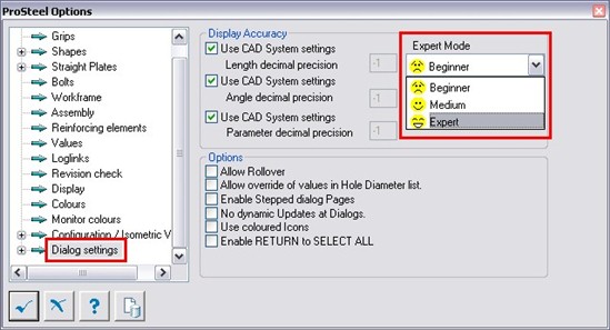

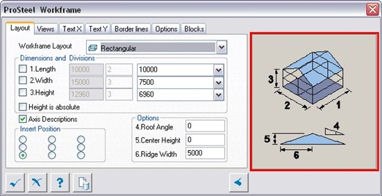

From the ProSteel Options dialog box, you can configure different display properties. The following options are available for selection: Beginner, Middle and Expert. This setting has an influence on the display of constructional graphics in the dialogs and more.
By Setting the Dialog settings to Expert mode, additional settings are available under Options Tab
Files Access to the most important system files
** Please note that you have access to this page only via “Expert Mode”, because the modifications made here have a decisive influence on the operation of the program.

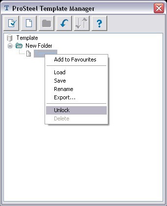

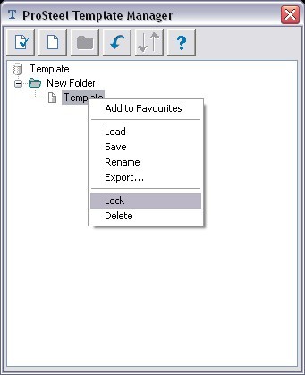

LOCK Select this command to lock the selected template against overwriting. This function is only available in expert mode.
UNLOCK Select this command to unblock templates which were blocked against overwriting. This function is only available in expert mode.

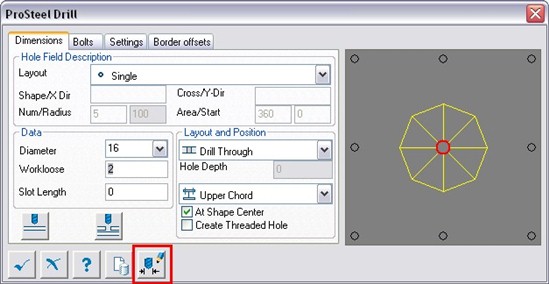

If you have activated the “Expert” mode in the global settings, this button will be additionally displayed in the ProSteel Drill dialog box. It permits editing of the diameter table.
Working in Expert Mode also removes the ProSteel Auxiliary Graphics.
