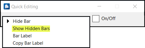

1) In the ‘Drawing Production’ tab, click on the ‘Quick Edit’ tool
2) In the ‘Quick Editing’ toolbox, choose the ‘Show Hidden Bars’ option
3) Now, turn on the check mark for On/Off
4) All hidden rebars will get turned on and displayed as a line
5) To get the full 2D rebar to be displayed back, apply the Hide Bar tool once again on this hidden bar line
