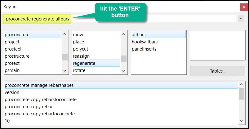

6) Finally, start the ProStructures application again and open / create a model. Run the Key-in ‘proconcrete manage refreshcodes’
7) Followed by this, run the next Key-in ‘proconcrete regenerate allbars’
8) Now, use any of the rebar modelling tool to place this newly added bar size
