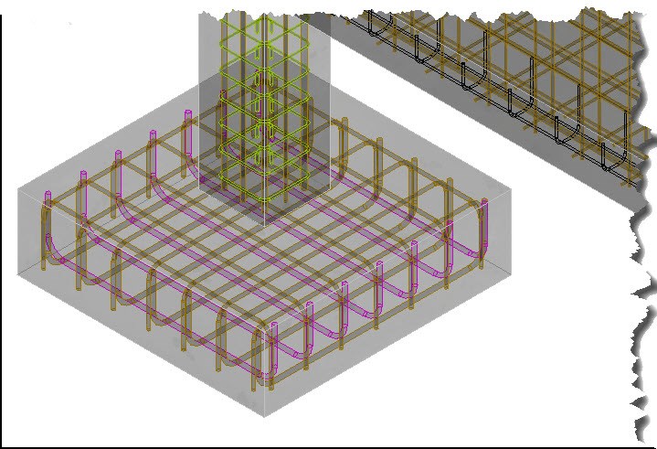

How to check which is the parent concrete or concrete owner for a Rebar / RebarSet / Rebar Assembly ?
Steps to resolve

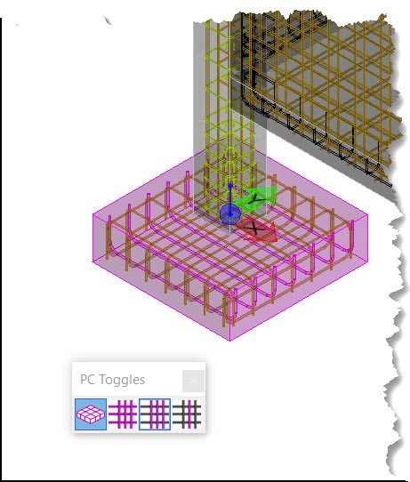

1) In the PC Toggles, select the Rebar Owner option along with one of the Rebar Selection options
2) Now select any rebar / RebarSet /Rebar Assembly in the model. The parent concrete object will also get highlighted in connection with the intended RebarSet
