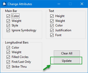

4. Now  go to Drawing Model and in Rebar Attributes say update which will now apply your assigned Text Style.

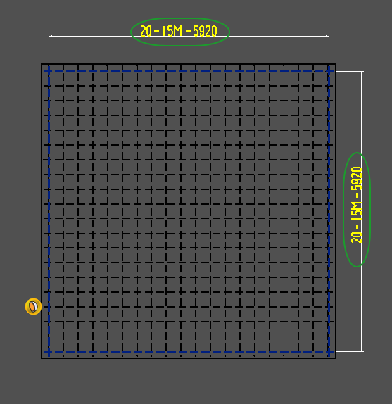

Now all your rebar labeling will come with your custom Text Style like below snap.
In this way one can define or assign custom Text Style.
