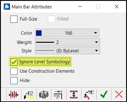

For any selected bar, you can modify the appearance of the reinforcement bars by adjusting the parameters in this dialog and clicking on the Save Modified Bar button
Method
1) The Full-Size option ensures that the bars are drawn to the full size outline rather than being represented by centerline of rebar
2) The Filled option causes the full size to be drawn as filled elements
3) The Color, Weight and Style will maintain the color, line-weight and line-style attributes of the reinforcement details
The color, weight, and style are applied independently of your normal DGN settings
NOTE - All three of these parameters are ignored if your reinforcement resides on a Layer where Symbology is activated
4) The Ignore Level Symbology option will ignore the Layer Symbology Settings (set within the Level Defaults dialog) and revert back to this Main Bar Defaults dialog for the required color, weight, and style attributes
5) When the Use Construction Elements option is OFF, all main bar elements adopt the Primary Class attribute
If the option is turned ON, they are created Construction Class attributes
Main bar elements of this type disappear from view when the Settings > View Attributes > Constructions option in Presentation is deactivated
6) When the Hide option is checked ON, the 2D bar elements are hidden
In this way, one can set up the display of the 2D rebar symbolization in the drawing model while detailing RCC structures
