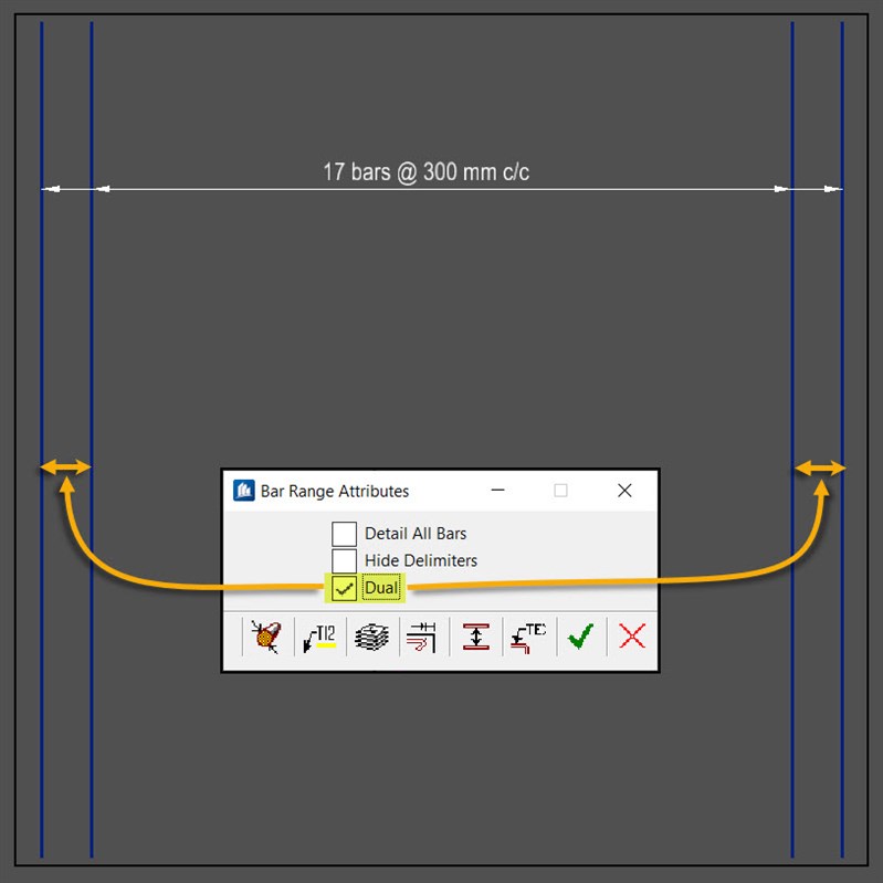

For any selected bar in a range (rebar set), you can modify the appearance of the reinforcement bars in this range by adjusting the parameters in this dialog and then clicking on the Save Modified Bar option
Method
1) The Detail All Bars option will display all the bars in the rebar-set
2) The Hide Delimiters option will turn of the display of the delimiter lines for the bars in range
3) The Dual option will display the first two and last two bars in the range with delimiters adjusted accordingly
