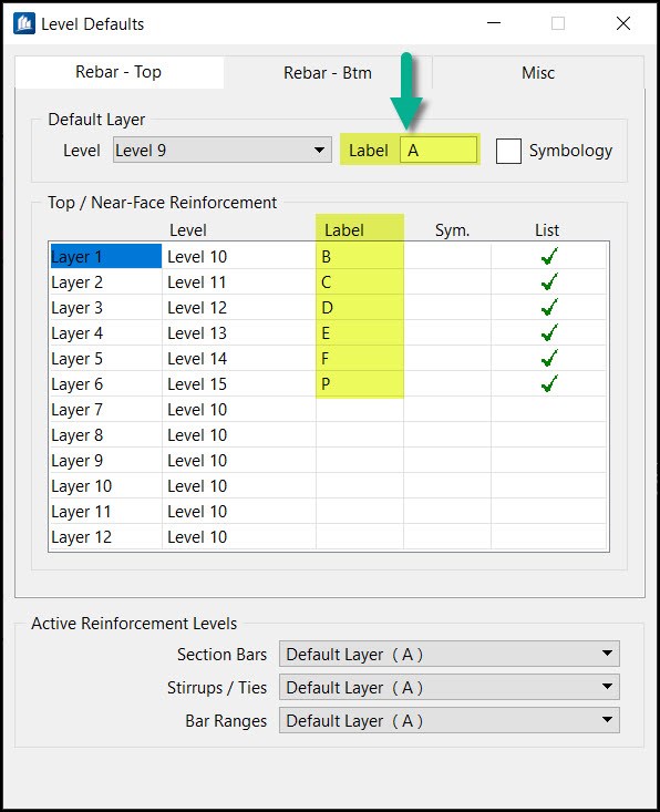

Level Attributes can be modified at any stage during the detailing process, thereby allowing you to override their current ‘default’ parameters of the 2D rebar layers / levels
1) The Level Attributes option will allow to set the 2D rebar on a particular Layer
2) To check for the available layers or set up new parameters, one can refer the Level Defaults tool
