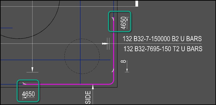

While detailing dense or congested rebar assemblies where the rebars overlap each other, it can get confusing to determine the end or extent of the rebar length. Thus, it is a common practice to display the ends of such over-lapping rebars as ticked (ends protruding outwards). You can do this by setting up the required parameters in the Bar End Details tool

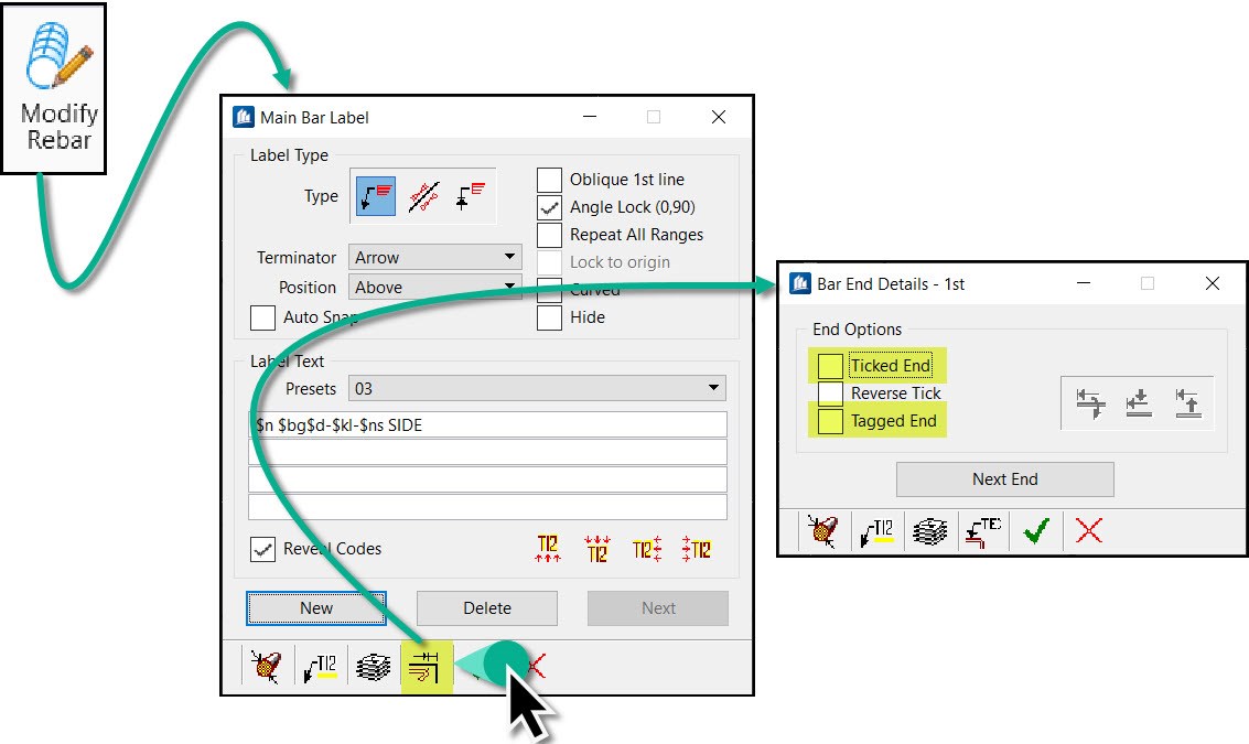

1) When detailing your view in the drawing model, click on the Modify Rebar tool and select the rebar you want to modify (edit)
2) Then select the Modify Bar Ends tool

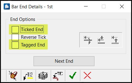

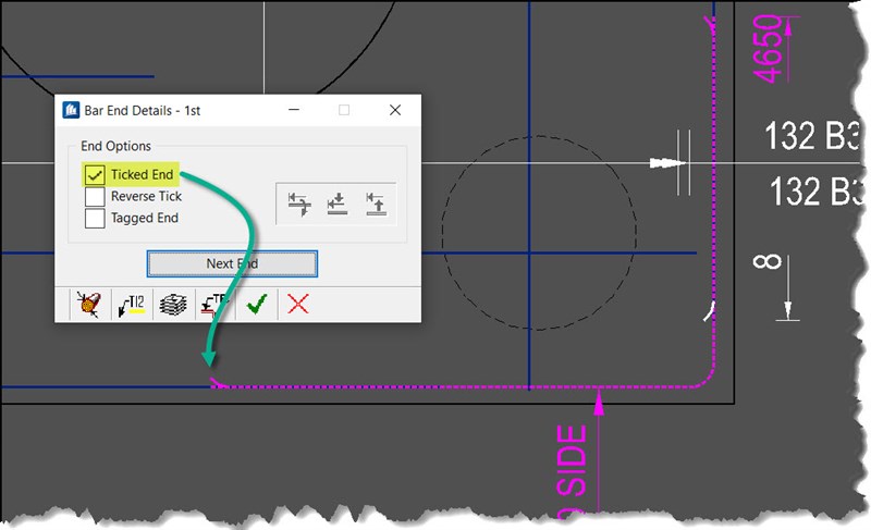

3) Here, check ON the Ticked End option. This will automatically also check ON the Tagged End option
4) You can also set this up for the other end of the 2D rebar by clicking on the Next End button and set up the same
5) If you do not require the tag labels, you can uncheck the Tagged End
6) Once done, click on the OK button to accept your modification
In this way, one can set up to display ticked ends with tagged labels for 2D rebars that overlap in the drawing model
