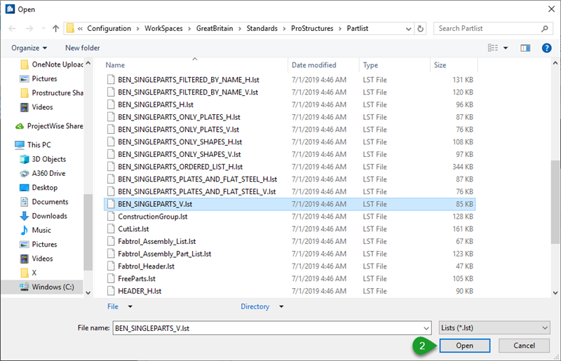

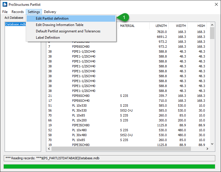

1. In ProStructures Partlist dialog, go to Settings > Edit Partlist definition, which will allow you to select  your lst file.
2. Click on Open and the file will be opened in Partlist Editor dialog

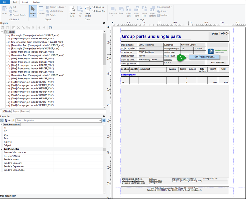

3. In Partlist Editor, go to Header block and right click and say "Edit project include".
4. In the next dialog when select any text please ensure in property, Pagebreak should be "No". If it is set to "Yes", then that text will not come in second page onward.
And this way you can achieve the test fields in second page onward.
