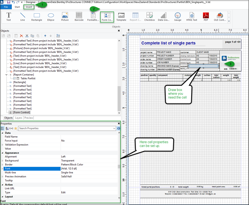

The Fillable cells can be created while editing in Part List Definition. This can be done via inserting Form Control. Please follow the below steps.

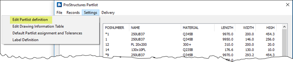

1. In Partlist > Settings Open Edit Partlist Definition.
2. Select your needed .lst file. E.g here "BEN_Singleparts__V.lst" is selected and open that file for editing.
3. When it is opened, go to Insert > Form Control from the main menu. And then insert the box where you want to create fillable cell. Through this way you can insert cell in Partlist header.

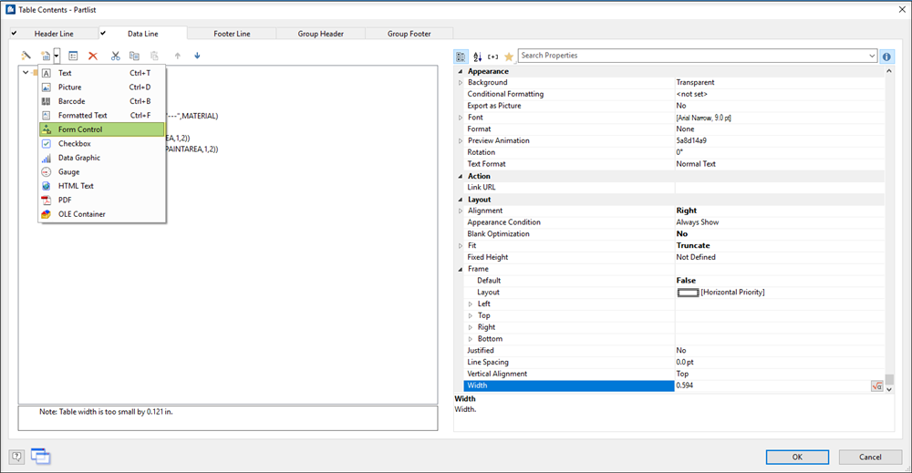

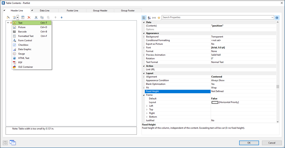

4. To create same type of cell in Data Table content, double click on the table space which will open up Table Contents - Partlist. There will be Header Line, Data Line. You can add new Text header to reserve the            column for  fillable cell. Then in Data Line you need to add Form control to get the fillable cell. Please not that only Form Control field will allow you to get fillable cell. Obvoiusly there are properties for that field
    where you can set other properties, like Text Height, Font etc.
