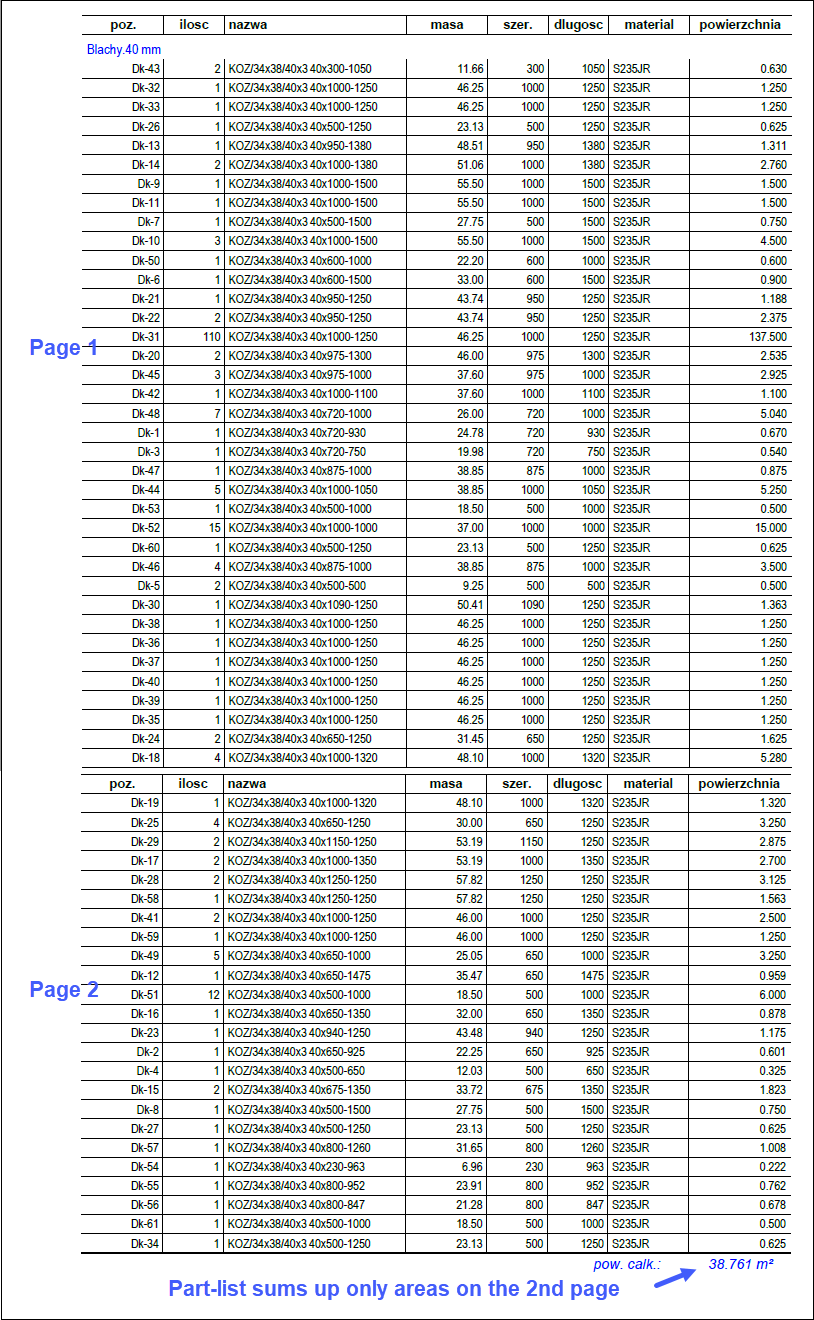

Original issue description:
There is something wrong with build in function summing up surface of plates.
It sums up only the last page of table. How should I set it up, to work properly.
I'm sending in attachment pdf file generated, partlist definition, and database file.

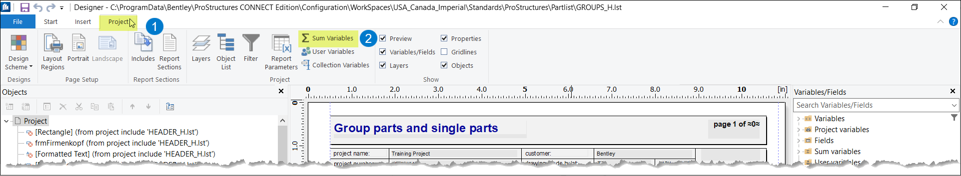

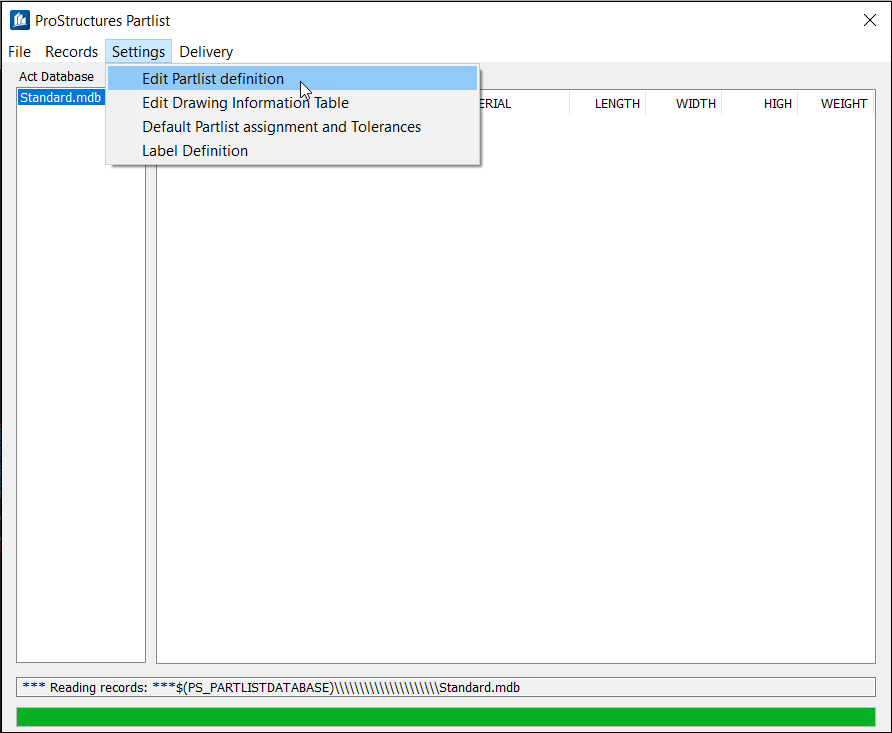

1. After creating the partlist database, under the settings go to the Edit Partlist Definition select the required .lst file.

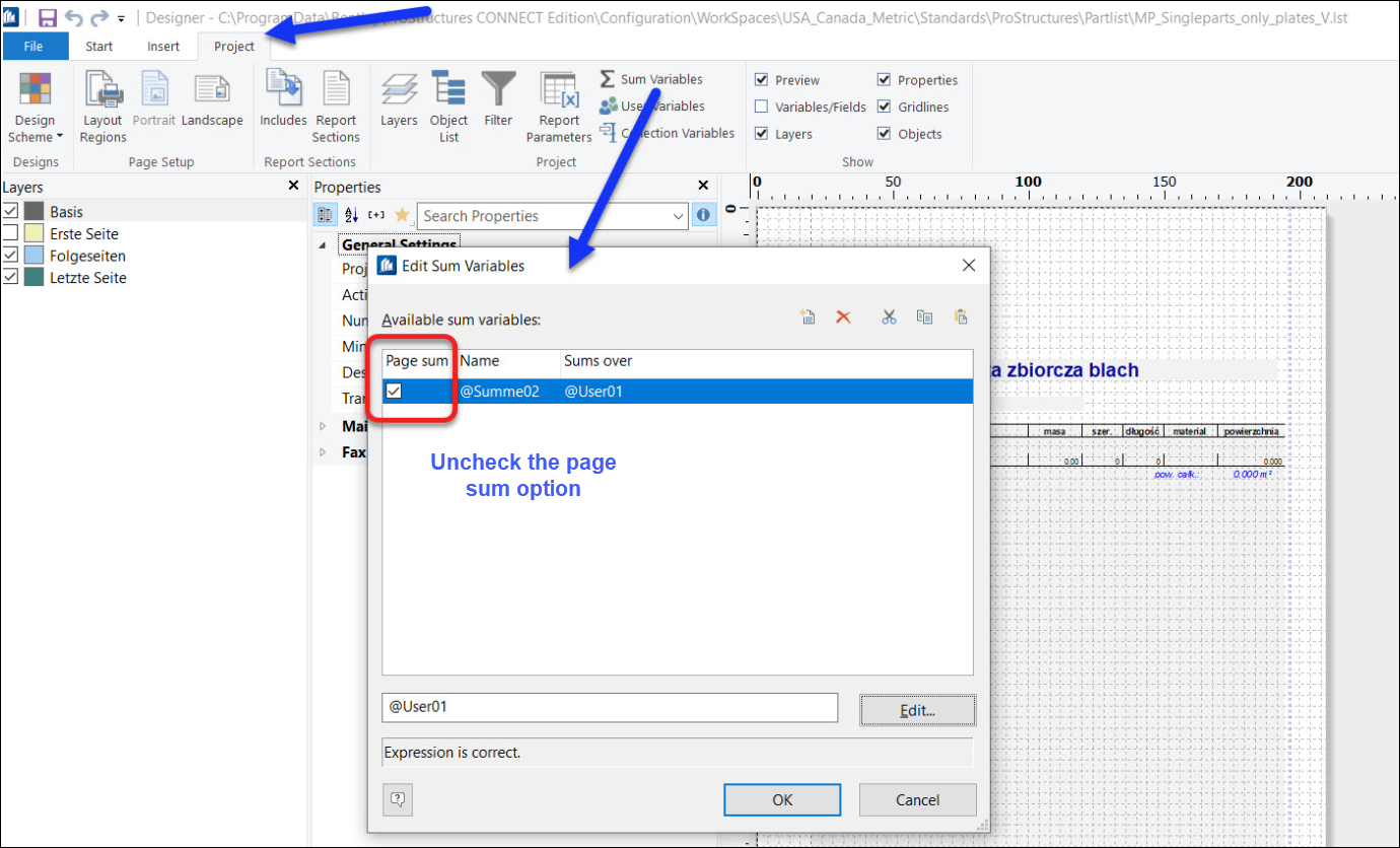

2. In edit partlist definition dialog, under the Project tab go the Sum Variables
3. In the edit sum variables, uncheck the option Page Sum. This will allow to calculate the sum of quantities present all pages.
In this way, you can calculate the sum of the quantities on all the pages.
