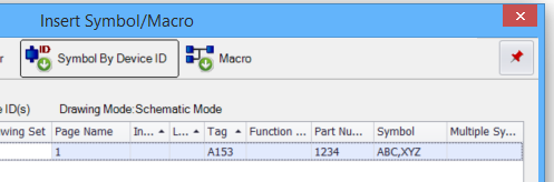

  2. In the field for specifying which symbol is to be used in the desired mode, enter the list of symbol names. Names of such fields end with "Symbol". The symbol names must be typed into the field, not browsed for, and should be separated by commas (,) with no spaces.
  3. After making changes, use [[Parts database changes not reflected in project|Show Differences]] button to update the part number information in the project, if applicable.

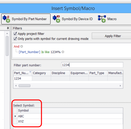

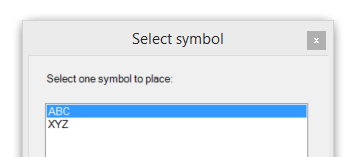

Now when using Insert Symbol By Device ID to insert a symbol for a device with that part number assigned, a Select Symbol dialog will appear after the Place Symbol button is selected.
When using Insert Symbol By Part Number, the desired symbol can be selected in the "Select Symbol" area of the Insert Symbol By Part Number dialog before clicking the Place Symbol button.
