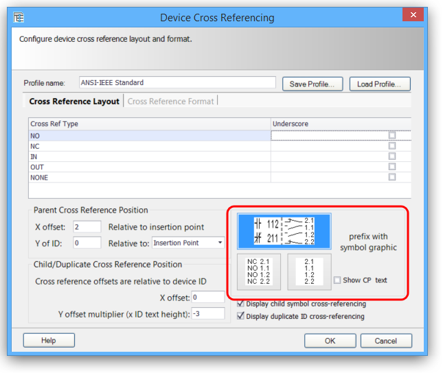

What are these miniature symbols in front of my cross reference text? I have them in some projects but not others. How do I add them? How do I get rid of them?
  1. Open a page of the project to be affected or select the project in [[Project Manager]].
  2. Select [[Options]] > Project Options > Display Formats.
  3. Click the Edit button next to "Device Cross Reference".
  4. Click one of the three choices in the area highlighted below.
    Choose prefix with symbol graphic to display small versions of the parent symbol as a prefix.
    Choose prefix with symbol type to display the "NO", "NC", etc. symbol type as a prefix.
    Or choose no prefix.
  5. Click OK. Click OK again then click Yes if prompted with "Do you want to update existing devices' formats in the project?"
