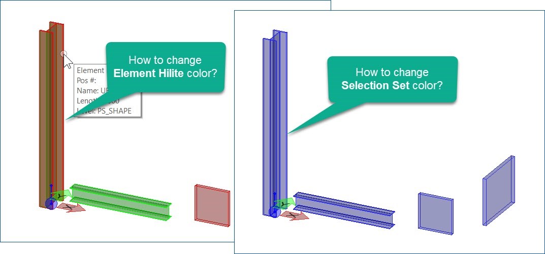

In this wiki, we are going to learn how to change the Element Hilite & Selection Set color.

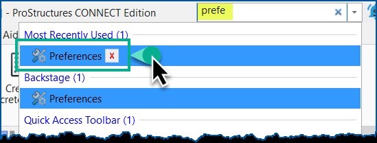

1. Type Preferences in the Search Ribbon and open it.

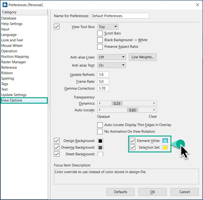

2. Go to the View Options tab, here you can change the color of Element Hilite and Selection Set. Once done, click on the OK button.

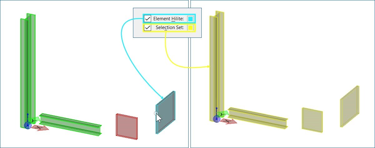

3. Now, in the model you can check the color for Element Hilite and Selection Set.
In this way, we can change the Element Hilite & Selection Set color.
