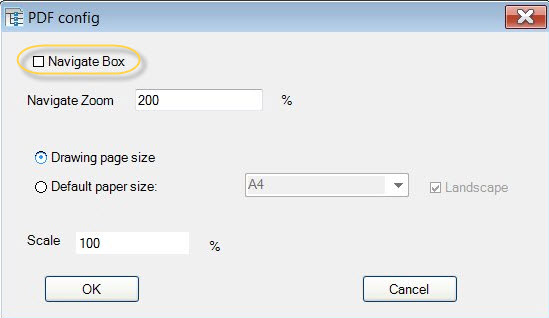

Problem Description
Blue boxes appear on the PDF published using [[Project Publisher - create PDF files of your projects|Project Publisher]].
The blue boxes in the PDF file indicate where to click to navigate to a related item.
How to Avoid
  1. Go to Project Publisher > Outputs > PDF file > Config. In the PDF config dialog, clear the Navigate Box check box for removing the navigation boxes.
  2. Publish the project again.
Note: Navigation will still work in PDFs created with Navigation Box disabled.
