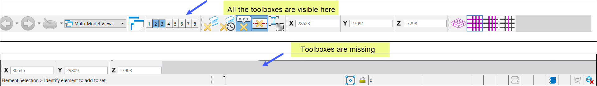

Several times, it may happen that the toolboxes present at the bottom may not appear or may look very small in the size. In this wiki, we will see how to resolve this Problem.

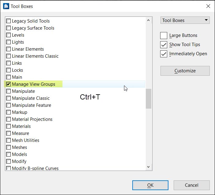

A) The tool boxes are not appearing at the bottom
1. These toolboxes are not appearing because they are not loaded in the program. For that you need to follow the steps below.
2. Press Ctrl+T which will open the dialog for the display of Tool Boxes and make sure the toolbox which you are looking for is turned on for display.

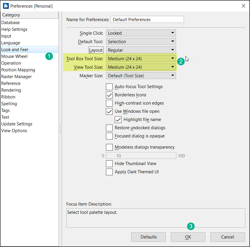

B) The toolboxes are appearing small.
This happens when the size of the toolboxes is set to small. Follow the steps below to increase the size of the toolboxes.
1. Navigate to backstage Files>Settings>User>Preferences.
2. Under Preferences, go to the ‘Lock and Wheel’ section and set the size of the Toolbox size to Medium or large
( avoid the small size of toolboxes)
In this way, you can resolve the concerns related to the display of toolboxes.
