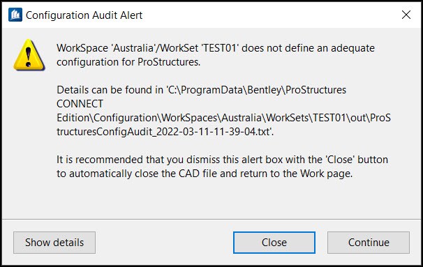

How to avoid the Configuration Audit Alert message?

This wiki will guide you on how one can avoid the Configuration Audit Alert message that pops up when opening a new file from the new WorkSet.

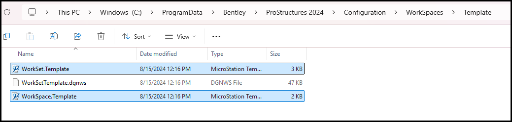

1. Go to the below path and look for WorkSpace.Template and WorkSet.Template files.
Path: C:\ProgramData\Bentley\ProStructures CONNECT Edition\Configuration\WorkSpaces\Template

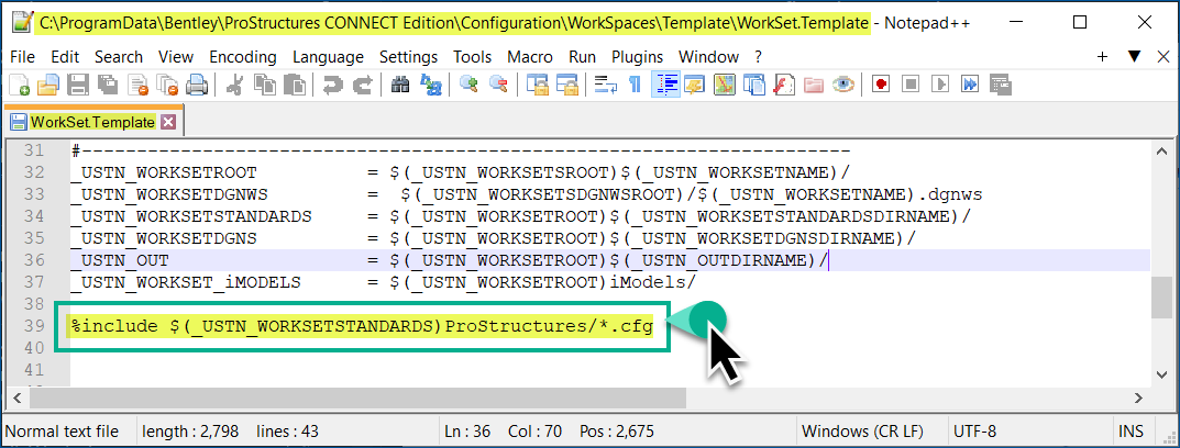

2. Then, add the below variable statement in the WorkSpace.Template.
%include $(_USTN_WORKSPACESTANDARDS)ProStructures/*.cfg
3. Now, add also the below variable statement in the WorkSet.Template.
%include $(_USTN_WORKSETSTANDARDS)ProStructures/*.cfg
With this, when you create a new file in the new WorkSet then that Configuration Audit Alert message will not appear because that statement is prefilled automatically inside the <WorkSetName>.cfg file.
