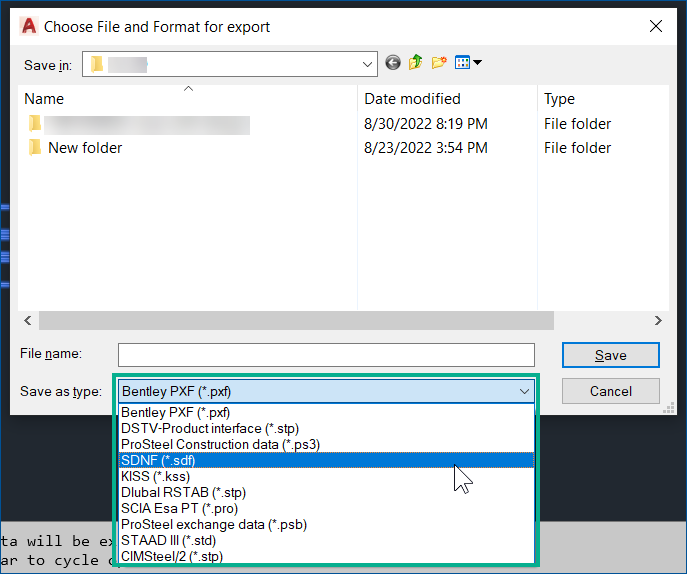

Export formats from ProSteel:
1. In the command type PS_Export to open the export dialog, here you can find the below export formats from the ProSteel.
2. Apart from above exports formats, there are few more available as shown in the below image.
Export formats from AutoCAD:
3. And below are the export formats from the AutoCAD export.
When you click on the Other Formats as shown in the above image then the following export formats will be shown.
