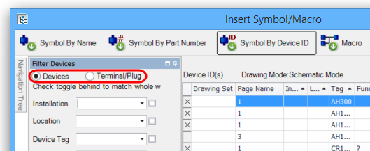

Terminals, plugs missing from Insert Symbol By Device ID
Product(s):Promis.e, Bentley Substation
Version(s):through 10.00.00.232
Environment: N\A
Area: Component Features
Subarea: Insert Symbol By ID
Problem Description
When I try to insert a symbol for a terminal block or plug that exists in the project using Insert Symbol By Device ID with the Terminal/Plug filter enabled, the device IDs I'm looking for are not listed.
Explanation
The software may be considering the terminal blocks or plugs to be standard devices, in which case they will appear when the Device filter is applied.
Historically, the type of schematic symbol placed for a device determined if the device appeared under the Terminal/Plug or Device filter, and if the schematic symbol was not placed first, then a terminal could become stuck as a Device.
