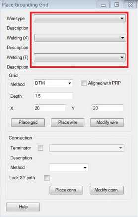

Grounding Grid dialog box is empty
Product(s):Bentley Substation
Version(s):through 08.11.13.140
Environment: N/A
Area: Grounding Grid
Subarea: Place Grounding Grid
Problem Description
When trying to place the grounding grid, the Place Grounding Grid dialog box comes up as empty without any options to select the grounding grid parts.
Grounding grid parts numbers must have specific Part _Type values in order to appear on the Place Grounding Grid dialog. These values include GGClamp, GGROD, GGWROD, GGWT, GGWX, and GGwire.
How to avoid
Ensure the correct parts database path is active on [[Setup]] > System Paths.
If the correct parts database is active, use [[Parts Database Manager]] to add grounding grid part numbers and assign the appropriate values to the Part_Type field for each. Refer to the [[Part_Type filter values]] article.
