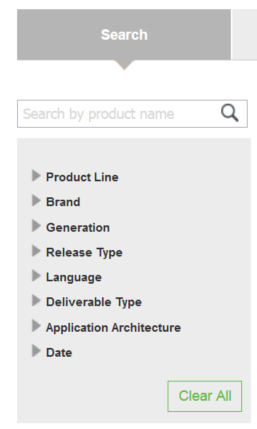

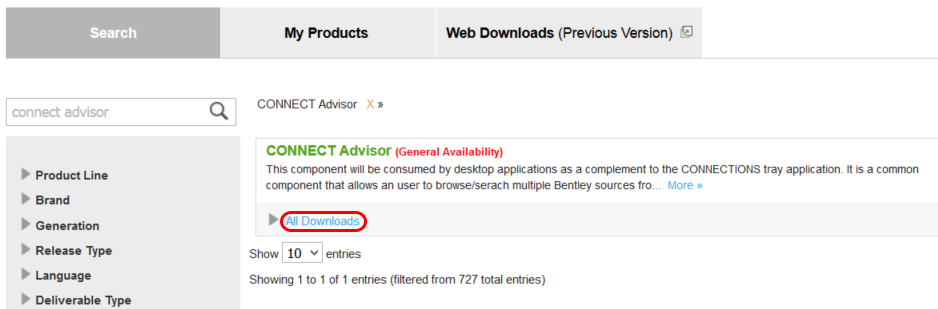

You can also download CONNECT Advisor V8i from the Fulfillment Center using the following steps. Note: CONNECT Advisor is included with CONNECT Edition products and does not require this separate download.
