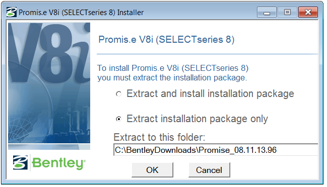

- Run the downloaded installation file. For example, pes08111396en.exe.
- Choose the Extract installation package only option and note or specify the destination folder, typically a subfolder of C:\BentleyDownloads\ such as C:\BentleyDownloads\Promise_08.11.13.96. Click OK.

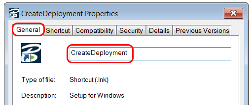

- Using Windows Explorer, right-click setup.MSi.exe in the folder noted in step 2 and select Create Shortcut.
- Right-click the resulting setupMSi.exe – Shortcut item and select Properties.
- On the General tab, change setupMSi.exe – Shortcut to CreateDeployment

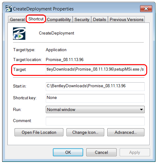

- On the Shortcut tab, append /s to the end of the Target field. The Target field should end up looking something like:
C:\BentleyDownloads\Promise_08.11.13.96\setupMSi.exe /s
![](93544d7847fd42909091861f536d43e6.iix)
- Click OK.

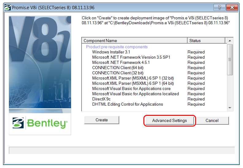

- Double-click the CreateDeployment shortcut created in the steps above and click Yes on the User Account Control prompt.
- On the first dialog that appears, click Advanced Settings.

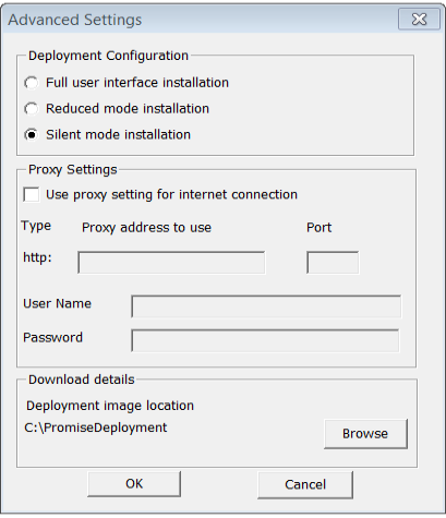

- Select the Silent mode installation option.
![](84644d7847fd42909091861f536d43fd.iix)
- Click Browse, then create and select a C:\PromiseDeployment folder as the path where the deployment image will be created. Set any Proxy Settings necessary at your site. Click OK.
- Consider disabling the installation of Visualization Content, this is not Substation-specific material.
- Click the Create button. Proceed through the rest of the process, choosing the options that you want the deployment image to install. This includes the paths of the application and data folders, the electrical standard, and which shortcuts to install (desktop, start menu, etc.). Pre-requisite components will be downloaded and added to the deployment image.
- Click Finish when the process is complete.
