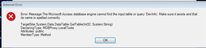

One of the following error messages appear while inserting, creating, or modifying symbols.
Internal Error
Error Message: The Microsoft Jet database engine cannot find the input table or query 'BlkInfo'. Make sure it exists and that its name is spelled correctly.
Internal Error
Error Message: The Microsoft Jet database engine cannot find the input table or query 'DevInfo'. Make sure it exists and that its name is spelled correctly.
