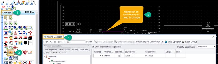

Wiring Manager, introduced in the V8i SELECTseries 7 versions of  Promis.e and Bentley Substation, replaces [[Assign/Edit Wire Number]] and [[Forced Routing Manager]].  Wiring Manager is used to assign wire tags (wire numbers), wire properties, and change (force) connections/routing.  Click the Help button on the Wiring Manager dialog for more information.

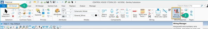

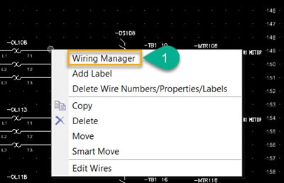

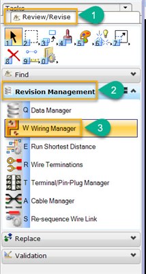

To start the Wiring Manager tool
* is used to denote a menu selection that is not necessary in some versions or platforms.
For Bentley Substation CONNECT Edition
V8i SELECTseries 7 and 8
promis.e 2007 through promis.e/Substation V8i SELECTseries 6

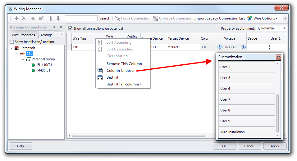

To assign a wire property that has no column
  1. Right-click any column header and select Column Chooser.
  2. Find the property on the resulting Customization box and double-click it.
  3. Click the red X on the Customization box to close it.
  4. Add value(s) in the newly added columns.

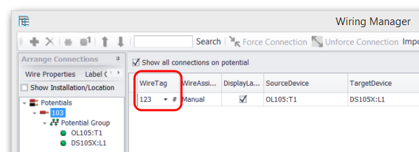

To manually assign a wire number
Click in the Wire Tag column and type the desired value. Click the # button to populate the field with the next available tag. The Wire Installation and Wire Location columns can be added as described above.
Other Tips
Rearrange columns by dragging them.  To drag a column, click the column header and hold the mouse button.  Move the mouse and release the mouse button when the column header is in the desired position.
Remove columns by right clicking the header of the unwanted column and select Remove This Column.
