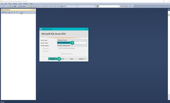

  1. In SQL Server Management Studio, connect to the server. SQL Management Studio if not installed on your machine then follow the Wiki Link Install SQL Server Management Studio for the details steps for installing SQL Management Studio.

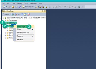

  2. In the Object Explorer tree expand Security > Logins.
  3. Create the login if it does not already exist by Right Click on Login and Select New Login.
  4. If need to make changes to existing Login, Right-click the existing User login and select Properties.

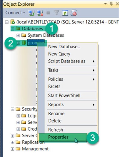

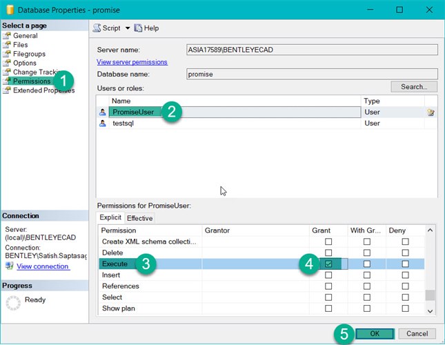

  9. Right-click the project database in the Object Explorer tree and select Properties.
  10. Select the Permissions page.
  11. Select the user in the top pane.
  12. Check the box in the Grant column for the Execute permission in the bottom pane.
  13. Finally, click OK.
