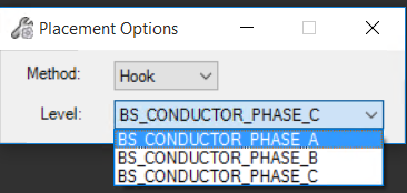

In Bentley Substation CE Update5 we introduced the ability to select unique phase levels for cables or bus so that they can easily be distinguished for clash detection purposes.
- Click Insert Cable/Bus Object 3D Design, select a cable, and click Insert to initiate the cable placement.
- Select the desired Phase Level from Placement Options dialog.

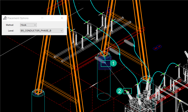

- Select the Hook points between to and from equipment between which Cable/Bus needs to be placed, and after selecting both the Hook point if using Hook point method for placing the cable Cable/Bus Setting dialog will appear and then click Ok after making required changes in the settings
Note: Specify the Sag Algorithm and other desired settings as seen in below Cable/Bus Object Setting dialog and then Click OK to the to complete the placement.
