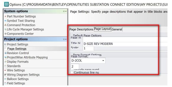

When using OpenUtilities Substation on a machine which has a high-resolution screen like 4K Screen the dialogs sections Description, dropdown list or other objects overlapped on one another which makes it hard to understand the Description and selecting the corresponding dropdown list or other objects.

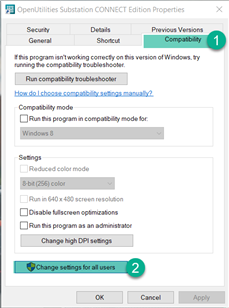

1.Right-click on Substation icon on your desktop and select Properties.
2. Next select Compatibility Tab >> Change Setting for All users under the OpenUtilities Substation properties dialogs.

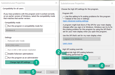

3. Next click “Change high DPI settings” in Substation.exe dialogs and the resulting dialogs check the option to select “Override high DPI scaling behaviour” and select the “Scaling Performed by” as “System (Enhanced)” and select Ok on all the dialogs to save the settings.
By these steps, you can resolve menu issue on High-resolution screens.
