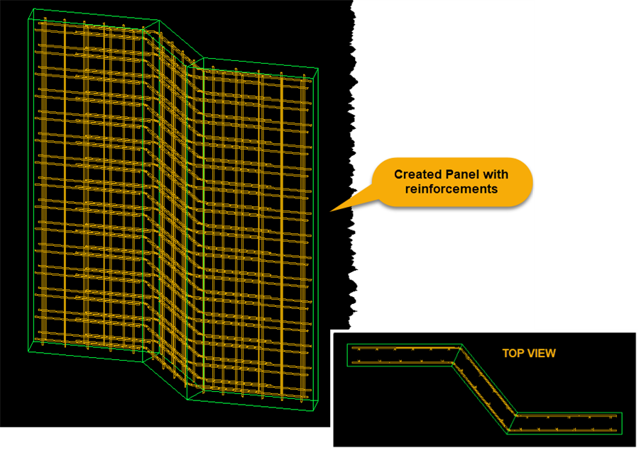

When modeling irregular panels, there are instances that these are not orthogonally-arranged and may come in different orientation as per design requirements. Therefore, this document will guide you how to create these panel reinforcements.

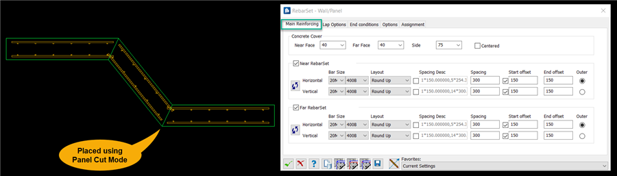

1. Open the Wall/Panel RebarSet tool which can accessed from Concrete workflow > Home > Rebar Placement > Wall/Panel RebarSet
2. Set the bar size, spacing, offsets and concrete cover as per your requirements for each of the panel in the Main Reinforcing tab.

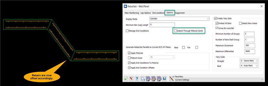

3. At the joints, we can observed that some rebars are extended following a standard arrangement. To align these rebars to their corresponding concrete assignments, you need to uncheck the Extend Through Mitered Joints in the Options tab.
