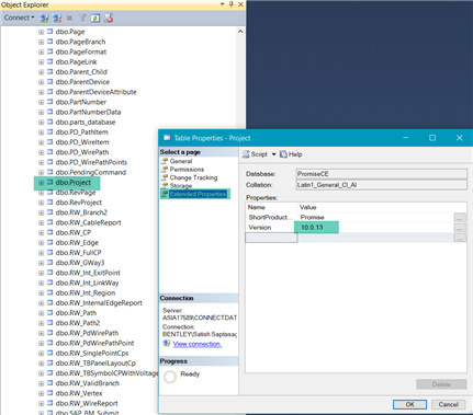

Determining the database version (SQL Server)
The current database version can be determined by connecting to the SQL Server using SQL Server Management Studio (SSMS) and checking the extended properties of the Project table in the database used by Promis.e.  In SSMS, expand Object Explorer > Databases > promise > Tables, right click dbo.Project, and select Properties > Extended Properties.
Alternatively, executing the following query will also return the database version.
use promise
SELECT * FROM fn_listextendedproperty ('Version', 'user', 'dbo', 'table', 'project', default, default)
Replace "promise" in the above query with the name of the database if different.
