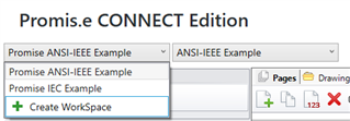

  3. Start Promis.e and from the Welcome dialog and select the “Start a Work Session” button

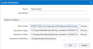

  4. Select the “WorkSpace Picker” and choose “Create WorkSpace” to create a new WorkSpace.
5. Enter a name for your workspace such as “MyCompany” and point the Root Folder path to the “MyCompany” workspace.
