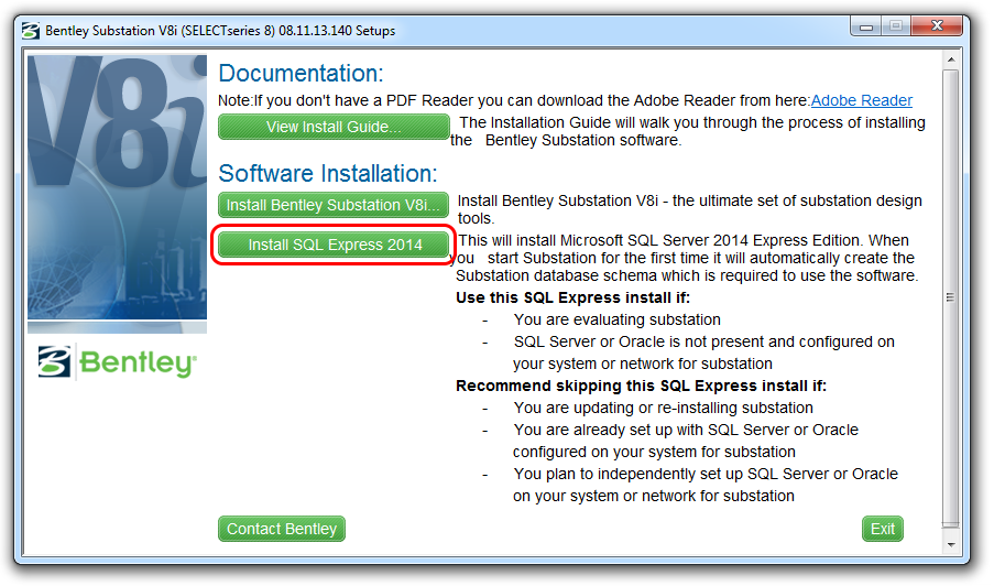

Note: This TechNote is normally not needed by users of Promis.e and recent versions of Bentley Substation since the installation files for that software include an option to install SQL Server Express.  For example, the following dialog is presented after running C:\BentleyDownloads\Substation_08.11.13.140\setup.exe
When installed from this dialog or by running LaunchSQLExpress.exe from the C:\BentleyDownloads\[Product]\SQL_Server folder, the SQL Server installation wizard is automatically configured with certain preferred parameters. The parameters include the BENTLEYECAD instance name. Unless there is a need (see above limitations of Express) to install a non-Express edition of SQL Server, users should consider using the Promis.e/Substation installation file to install SQL Server Express instead of downloading it from Microsoft.
