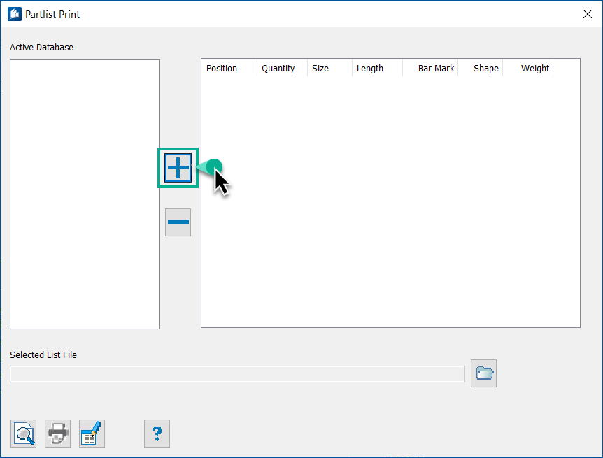

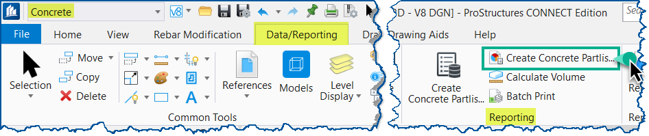

1. Open the   Create Concrete Partlist tool located Under the Concrete workflow > Data/Reporting > Reporting > Create Concrete Partlist.
2. It will open the Partlist Print dialog, click on the   Plus button to load the database file.

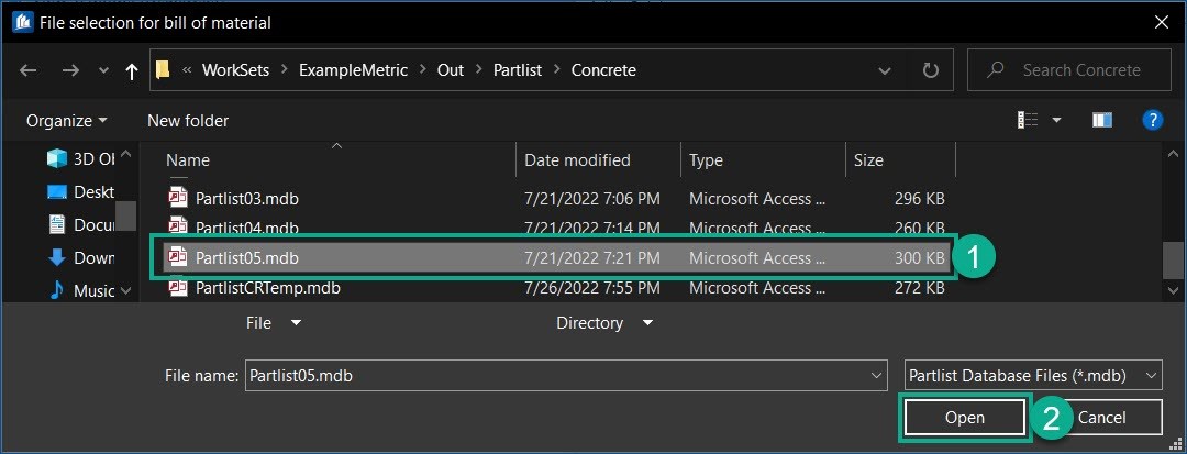

3. Select the partlist database file that you want to load into the Partlist Print dialog and click on the Open button.

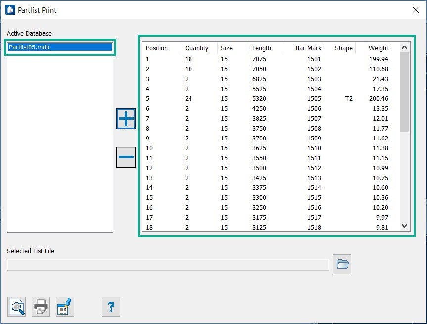

4. It will take some time based on the file size and will load the data into the Partlist Print dialog.
In this way, we can load the existing partlist database (MDB) file in the Partlist Print dialog and can continue to create the partlist by selecting required list file.
