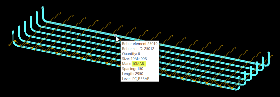

1. Select the rebars and then   load them in the Schedule Generator or the Manual Marking tool.
2. Enable   Hilite Bar, Isolate Bars, and Zoom to Bars in the Manual Bar Mark Manager or Schedule Generator tools. Then right-click on the required Bar Mark from the list and select Locate Rebar elements in Model.
3. It will now Hilite, Isolate, and Zoom to the rebar as shown in the below image.
In this way, you can locate rebar elements in the model using Manual Bar Mark Manager or Schedule Generator tools.
