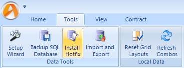

1. Once you get the download link from us then download the hotfix at your required location. This Hotfix will install the three new Interfaces.
2. Open the STRUMIS application.
3. Navigate to the Tools ribbon, then click on the Install Hotfix.
4. Browse and select the Hotfix file saved in step 1.
5. You should get a message saying, “Hotfix Install successful”.

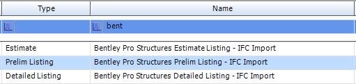

6. At this point, you should have three new Cad Interfaces. You can choose the one as per your requirement.
In this way, we can import the ProStructures IFC file into the STRUMIS application by using the Hotfix. If you are facing any issues while following the above steps then please create a service request on the same, so that we can help you to resolve your queries.
