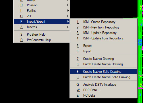

For ProStructures Dgn files use from menu “Create Native solid drawing”:

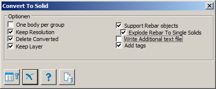

Use the following options
Note that this dialog is from a future version of ProStructures. The SS7 version you will get popups for each of the settings.
