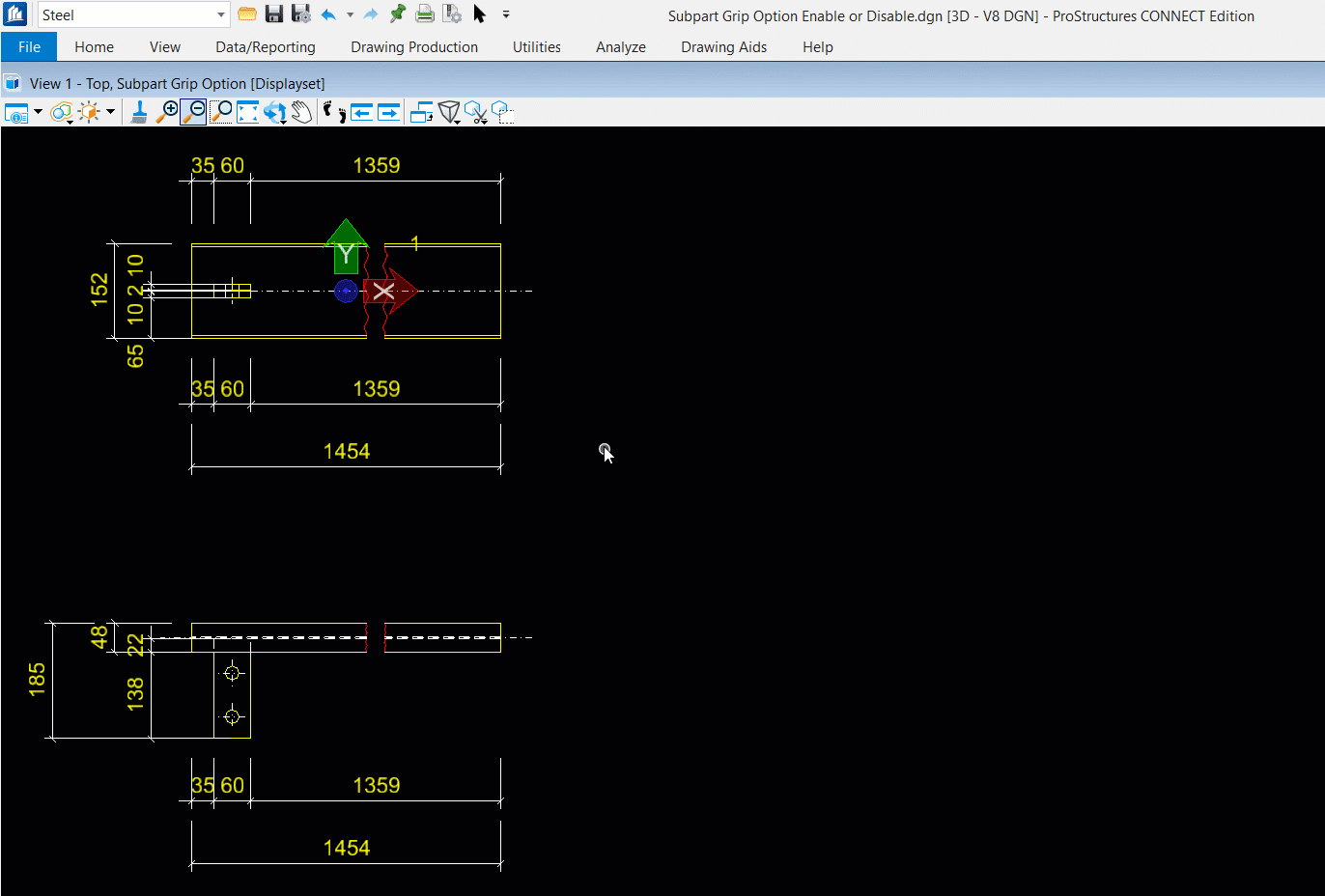

There are two ways to enable or disable the Subpart Grip option in the ProSteel CONNECT Edition. Please follow the below steps to achieve this.
A] From the Context Menu:
Open the Context Menu by holding the right mouse button in the open area of the View window and from here one can enable or disable the Subpart Grip option.
B] From the Key-in:
Open the Key-in dialog and type ‘ProStructure Set Pickhelper’ in the search bar and hit the enter. By using this key-in one can turn on/off the Subpart Grip option.
In this way, by both the methods one can enable or disable the Subpart Grip option in the ProSteel CONNECT Edition.
