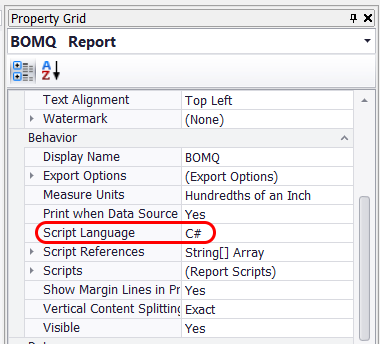

The script language specified for the template and the language used in the scripts must be the same. The language specified for the template can be found by looking in the Script Language field in the Property Grid immediately after opening the template or by right-clicking the root node in the Report Explorer tree and selecting Properties:

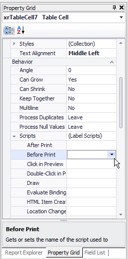

  6. On the resulting Property Grid view, expand the Scripts row.  The Scripts row is in the Behavior category.
  7. Click on the Before Print row.
  8. Click the down arrow button that appears in that row.
  9. Choose New from the drop-down list.  This will open the Scripts view and create a new function.
