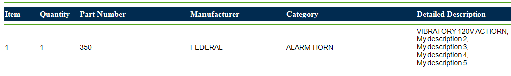

Concatenating fields with each field on its own line
This example concatenates the Detailed_Description fields on a Quantified BOM report template. It adds a comma and a new line between each. Because the process of combining the fields was repetitive, the concatenation is done by a separate function that is called repeatedly.
The BeforePrint script that is bound to the cell in the report template calls the concatenatedescr function for each field to be concatenated. The concatenatedescr function only adds commas and new lines when there are additional description values, so there is no wasted space when the report is run.
For this example to work, the cell that is bound to the BeforePrint script must have the Multiline property set to Yes. This property can be found in the Behavior category of the Property Grid for the cell (right-click the cell and select Properties).

// just set it to the concatenated string value { retconcat = c; } return retconcat; } private void xrTableCell12_BeforePrint(object sender, System.Drawing.Printing.PrintEventArgs e) { string concatenated = ""; concatenated = concatenatedescr ("Detailed_Description1",concatenated); concatenated = concatenatedescr ("Detailed_Description2",concatenated); concatenated = concatenatedescr ("Detailed_Description3",concatenated); concatenated = concatenatedescr ("Detailed_Description4",concatenated); concatenated = concatenatedescr ("Detailed_Description5",concatenated); (sender as XRLabel).Text = concatenated; }
